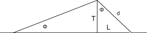

( The angle $\phi$ is exaggerated in figure)
A very small displacement, d, would create a very small angle, ϕ, with the strings original position. The transverse displacement, T, would be proportional to d∗cos(ϕ) and the longitudinal displacement,L, would be proportional to d∗sin(ϕ). So as ϕ tends to zero the transverse displacement would tend to d and the longitudinal displacement would tend to zero.
