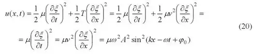

The energy of an element of a traveling wave is not constant. Halliday-Resnick-Krane is right. For a string of density $\mu$ and tension $T$ the kinetic energy of an element $dx$ is $$dK=\frac 12\mu dx\left(\frac{\partial \xi}{\partial t}\right)^2.$$ For the potential energy we have $$dU=Tdl,$$ where $dl$ is the stretched amount of the string. A small section $dh$ of the string is the hypotenuse of a right angle triangle with basis $dx$ and height $\frac{\partial \xi}{\partial x}dx$. Hence the amount stretched is $$dl=\sqrt{dx^2+\left(\frac{\partial \xi}{\partial x}\right)^2dx^2}-dx=\frac{dx}{2}\left(\frac{\partial \xi}{\partial x}\right)^2.$$ In the last equation we neglect higher order terms in $\left(\frac{\partial \xi}{\partial x}\right)$ since we assume small displacements. Then $$dU=\frac{Tdx}{2}\left(\frac{\partial \xi}{\partial x}\right)^2.$$ Therefore $$dE=dK+dU=\frac 12\mu \left(\frac{\partial \xi}{\partial t}\right)^2dx+\frac{T}{2}\left(\frac{\partial \xi}{\partial x}\right)^2dx.$$
For a progressive harmonic wave $\xi(x,t)=A\cos(kx-\omega t)$ we get $$dE=\frac 12\mu\omega^2 A^2\sin^2(kx-\omega t)dx+\frac{1}{2}Tk^2A^2\sin^2(kx-\omega t)dx.$$ Using $v^2=T/\mu$ and $\omega=vk$ we get $$dE=\mu\omega^2A^2\sin^2(kx-\omega t)dx,$$ which is not constant.
Remember that energy is being transmitted by the wave along the rope. The source of energy being the harmonic oscillator that generates the wave at one end of the string. So it is not a problem that the energy at each point is not constant. Another important point: The reason the result is quite different to what we expect when we think about simple harmonic motion (which gives constant energy for the particle) is that the element of the rope is not only moving transversely. A wave in a rope always have a longitudinal component. This was implicit when we computed the potential energy and assumed the stretched amount was the $dl=dh-dx$. Notice that when the element $dx$ has displacement $A$, it is at rest having vanishing kinetic energy. Moreover this element is not stretched, $\frac{\partial \xi}{\partial x}=0$, giving vanishing elastic potential energy. This does agree with the equation obtained for $dE$.

There are already good answers here, but I'm afraid that to the best of my knowledge, Diracology's (and indeed Halliday-Resnik-Krane's) expression of the potential energy is not correct. I would like to point to this paper by Lior M. Burko which focusses on the subtleties of the derivation of the kinetic and potential energy of the string as a whole and small mass elements of it. From the Abstract:
We consider the energy density and energy transfer in small amplitude, one-dimensional waves on a string, and find that the common expressions used in textbooks for the introductory physics with calculus course give wrong results for some cases, including standing waves. We discuss the origin of the problem, and how it can be corrected in a way appropriate for the introductory calculus based physics course.
To extract the result from this work, instead of
$$dE=dK+dU=\frac 12\mu \left(\frac{\partial \xi}{\partial t}\right)^2dx+\frac{T}{2}\left(\frac{\partial \xi}{\partial x}\right)^2dx$$
it should read
$$dE=dK+dU=\frac 12\mu \left(\frac{\partial \xi}{\partial t}\right)^2dx+\frac{T}{2} \xi \left(\frac{\partial^2 \xi}{\partial x^2}\right)dx$$
According to the paper the two expressions give the same result for the global energy content of the string, but the energy densities are not the same. In Section IV it is demonstrated how this fixes some of the issues with an element not having constant energy in particular for standing waves.
