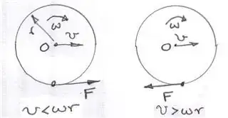

Update
Kinetic friction forces will try and reduce the relative motion between between two surface.
In the left hand picture imagine that the the rotational speed of the wheel $\omega$ is too fast or the translation speed is insufficient so that there is slipping between the tyre and the ground.
So the frictional force on the wheel due to the ground does two things to try and reduce the relative movement between the tyre and the ground.
  • The frictional force tries to increase the linear speed of the wheel to the right.
  • The torque about $O$ due to the frictional force tries to reduce the rotational speed of the wheel.
Both of these effects then making the wheel move closer to the no slipping condition $v = r \omega$.
The right hand diagram has the translational speed too great or the rotational speed to slow and in this case the frictional force tries to make the wheel rotate faster whilst at the same time trying to make the translational speed of the wheel slower.
