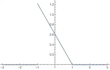

But I think the core of your question is whether you should be looking for a math mistake, or if something about the form of the wavefunction you've chosen causes this result to be invalid. There is, in fact, something wrong with the wavefunction: it's not continuous.
plot of wavefunction with a=1
When you calculated the momentum, I assume you used the integral $$\langle p\rangle = -i\hbar\int_{\infty}^{\infty}\psi^*(x)\frac{\partial}{\partial x}\psi(x)\ \mathrm{d}x$$ and you probably broke it up into pieces corresponding to the regions in which you've defined the function: $$\begin{align} \langle p\rangle &= -i\hbar\int_{\infty}^{-a}\psi^*(x)\frac{\partial}{\partial x}\psi(x)\ \mathrm{d}x - i\hbar\int_{-a}^{a}\psi^*(x)\frac{\partial}{\partial x}\psi(x)\ \mathrm{d}x - i\hbar\int_{a}^{\infty}\psi^*(x)\frac{\partial}{\partial x}\psi(x)\ \mathrm{d}x \\ &= -i\hbar(0) - i\hbar\int_{-a}^{a} A(a - x)(-A)\ \mathrm{d}x - i\hbar(0) \\ &= -\frac{3i\hbar}{4a} \end{align}$$ But this ignores what happens to the derivative at the point where the wavefunction is discontinuous, namely $x = -a$. Strictly speaking, the derivative is undefined there, and that makes one point at which you cannot evaluate $\frac{\partial}{\partial x}\psi(x)$. By ignoring that point, you come up with a meaningless result.
In quantum mechanics, we say that wavefunctions have to be continuous, for this and other reasons. My recommendation is that you abandon this example and pick a continuous wavefunction.
