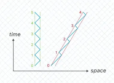

This diagram depicts two light clocks. The left light clock is stationary. The right light clock is traveling to the right at 60% of the speed of light.
The green and red lines represent the mirrors of each light clock.
The blue lines represent photons bouncing between the mirrors of each light clock. All 45 degree lines represent the speed of light. The numbers indicate ticks of the light clocks, which are counted when the photon strikes a clock's left mirror.
The right light clock ticks slower because half of the time, its right mirror is moving away from the photon, which takes longer to catch up with it.
After 5 ticks of the left light clock, the right light clock has recorded only 4 ticks, indicating that time dilation has taken place.

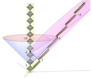

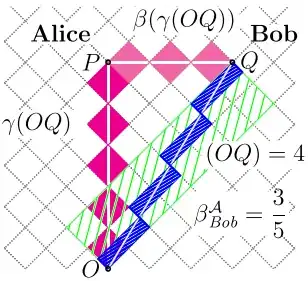

its probably be better to highlight the "invariance of the square-interval" via the invariance of the area of the triangle (more generally, causal diamond). This area invariance follows from the determinant of the Lorentz boost transformation being equal to 1. Additionally, the eigenvectors of the Lorentz boost preserve the edges to lie along the light cone.
Some details of this idea and some applications have been worked out in my article
"Relativity on Rotated Graph Paper"
American Journal of Physics 84, 344 (2016)
https://doi.org/10.1119/1.4943251
(see also: https://arxiv.org/abs/1111.7254 )
(see also: https://www.physicsforums.com/insights/relativity-rotated-graph-paper/ ) RRGP-robphy
The rotated graph paper makes it easier to draw the "ticks" of the light-clock (called light-clock diamonds) and, more importantly, calculate graphically with them.

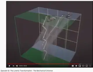

To address the comment to the OP by @thermomagnetic condensed boson
about visualizing the standard "transverse light-clock" on a spacetime diagram, one can view one of the episodes of
Caltech's Mechanical Universe , episode 42 (at 24m10s):
https://www.youtube.com/watch?v=feBT0Anpg4A&t=24m10s
Mechanical Universe-42

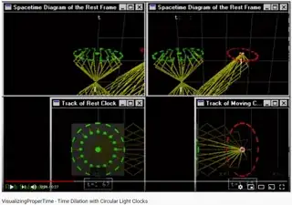

For a more complete visualization, one can look at an older article of mine
"Visualizing proper-time in Special Relativity"
Physics Teacher (Indian Physical Society), v46 (4), pp. 132-143 (October-December 2004)
https://arxiv.org/abs/physics/0505134
VisualiingProperTime-robphy
For an animation with "circular light clocks" (which include the transverse and longitudinal light clocks),
https://www.youtube.com/watch?v=tIZeqRn7cmI
VPT-robphy
