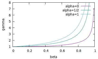

Obviously, for $\alpha==0$ we get $\gamma = \dfrac{\sqrt{(1-\beta^2)}}{(1-\beta^2)} = \dfrac{1}{\sqrt{(1-\dfrac{v^2}{c^2})}}$ as expected. But for other angles we get other values of gamma:

Let's look at the red side of the triangle in your diagram where $\alpha \neq 0$. In the frame where the clock is moving (the "lab frame"), this is the distance between the emitter and the receiver at the time the light is received—with all measurements made in the lab frame. By labeling it as "$ct$", you have made the implicit assumption that this red distance is equal to the distance between the emitter and the receiver as measured in a frame moving with the light-clock (the "clock frame").
The problem is that this is not necessarily the case. In the case where $\alpha = 0$, the distance between the emitter and the receiver is perpendicular to the relative motion, and it can be argued (via symmetry considerations) that distances measured perpendicular to the frames' relative motion must be the same in both frames.* But if $\alpha \neq 0$, there's a component of this distance that is parallel to the relative motion, and we are not guaranteed that the red distance in your diagram—which is measured in the lab frame—is in fact the same as the distance measured in the clock frame.
*Any source that doesn't make an argument concerning the invariance of perpendicular displacements before introducing the light-clock argument is taking questionable shortcuts at best.
