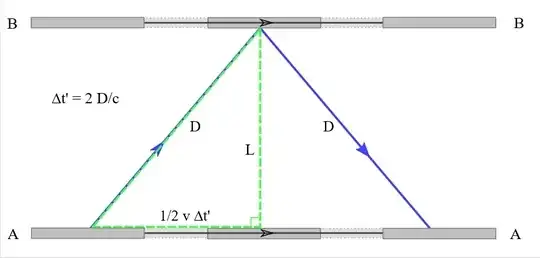

I used this diagram even though it is a two way clock.
Two way clock picture
Light clock A is oriented so its light moves tangentially to the observed direction of motion. Light clock B is oriented so its light moves parallel to the observed direction of motion.
In special relativity the length contraction effect can be derived by applying basic trigonometry to the light path. This is well established in text books, the distance $D$ that O observes the light in clock A to travel is $$D^2=\frac{L^2}{\bigg(1-\frac{v^2}{c^2}\bigg)}$$

1- I think in your first equation you must replace $L$ with $D$ and vice versa or you have to use $(1-\frac{v^2}{c^2})^{-1}$ instead of $(1-\frac{v^2}{c^2})$, because from O's viewpoint $D$ should be greater than $L$ according to your denotations for $D$ and $L$.
