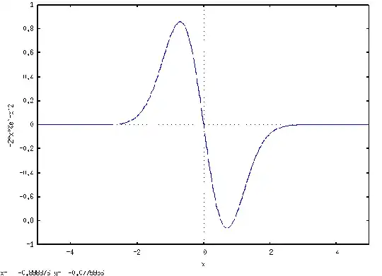

Now you see that there is really no solution for $\delta$-derivative potentials, at least in one dimension. As already somehow touched upon in the comments, this can be also seen from the fact that all $\delta$-derivatives look like "multi-peaks" of some kind, without any "overall" binding.
To better understand what I mean, consider $\delta'$, which can be obtained by a limiting process of the derivative of a gaussian:enter image description here
It is then somehat physically intuitive that the even though there are bound states in the well on the right, they are somehow eliminated by the infinite squeezing of this double-peak.
