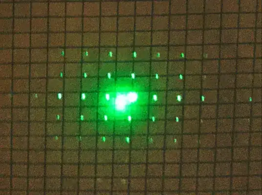

Your iPhone is a pretty good grating. I just did a simple experiment with an iPhone, a green laser pointer and a sheet of graph paper.
This was the result:
The display of the iPhone 6 has a resolution of 326 ppi - meaning we have a "grating spacing" of 25.4/326=0.0779 mm. Different models have different resolutions - make sure you find out what your phone has and don't just use the above. 6 Plus has 401 dpi, the 5 and 5s have 326 dpi. You can use pretty much any screen you happen to have lying around... if you can find the pixel size, you can use it.
In the image I see 5 peak separations over 7 squares (of 1/4 inch each), making the spacing 8.9 mm*

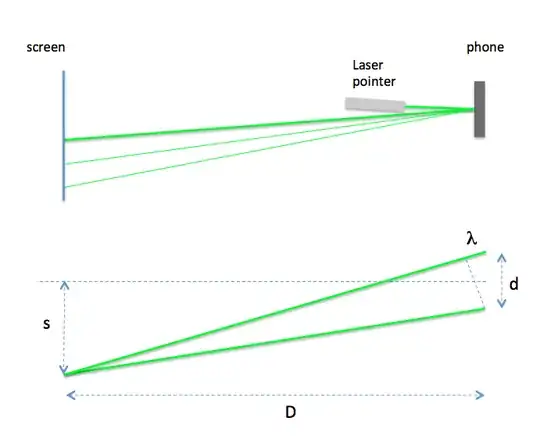

The grid paper was 127 cm from the face of the phone. We can calculate the wavelength by looking at the following diagrams:
Similar triangles tell us that $\frac{s}{D}=\frac{\lambda}{d}$ from which it follows that
$$\lambda = \frac{s\cdot d}{D}= 546 nm $$
That is pretty close to the 532 nm usually quoted for a laser pointer. Setting this up with a larger distance to the screen would have allowed more accurate estimation of the peak separation. Still - this got me to 3% without an optical bench (kitchen counter and kitchen ceiling, one hand holding laser pointer while taking picture with the other hand... Yes I would say 3% is OK and you can easily do better.)
*Looking more closely at the image, the dot spacing is a little bit less than 5/7 - using a ruler on the image I get about 8.75 mm. That improves the estimate to 541 nm... getting within 2% of the actual value. I doubt my exercise book paper is more accurate than that.

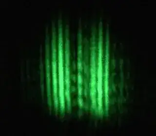

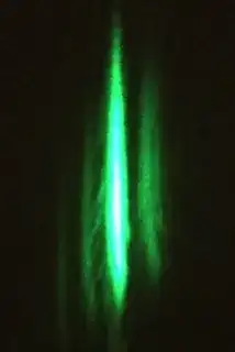

As @Benjohn pointed out you could try to use the front facing camera. It takes all kinds of things out of the equation but you lose some resolution. Here was my first attempt:
I then repeated it with a 6 Plus (finer resolution screen):
It looks possible to deduce the peak spacing directly from that...

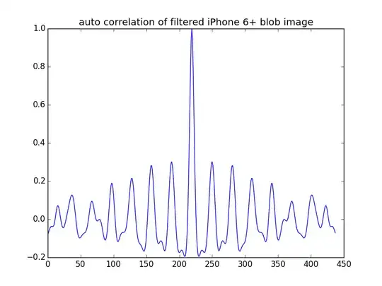

Re. the Fourier magic: this is the autocorrelation of the image after summing along Y dimension and performing a convolution with a Ricker filter first:

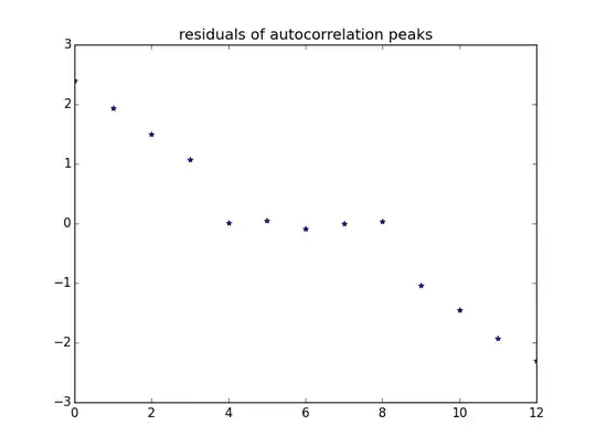

And a peak finding algorithm found the following peaks (after fitting to the central five points this was the residuals plot):
It can be seen that the peak spacing in the blob image could be estimated with remarkable precision. I attribute the fact that the final answer was "not that great" to the lack of careful calibration of the camera - not the image obtained. There is hope for this method.
