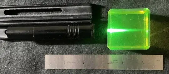

I do not have a 455 nm laser, but I do have a 405 nm laser pointer. Here is what happens when light from that laser pointer strikes a large uranium glass cube:
Uranium glass cube and 405 nm laser
As you can see, the uranium glass fluoresces green and the incident light intensity decreases significantly. But some of the 405 nm light makes it through the uranium glass cube, despite its thickness.

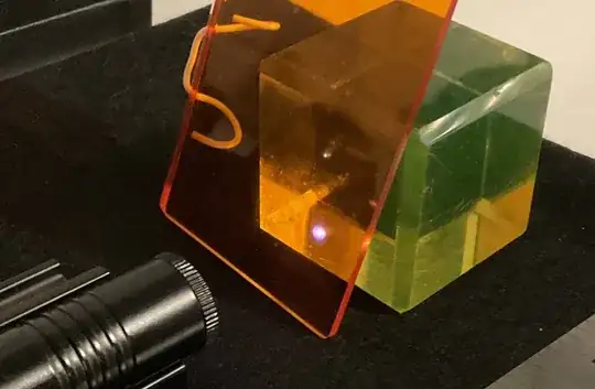

Now here I have placed a UV blocking piece of orange plastic between the laser and the uranium glass cube:
Blocking the 405 nm light
The orange plastic filter fluoresces yellow and it blocks essentially all the 405 nm light from the laser. The uranium glass cube does not fluoresce, indicating negligible 405 nm light got to it through the orange filter, and I tested with all the lights out. So the thin orange plastic did what it was supposed to do.
Bottom line: color of the acrylic plastic alone is not sufficient to risk your irreplaceable eye sight on.
