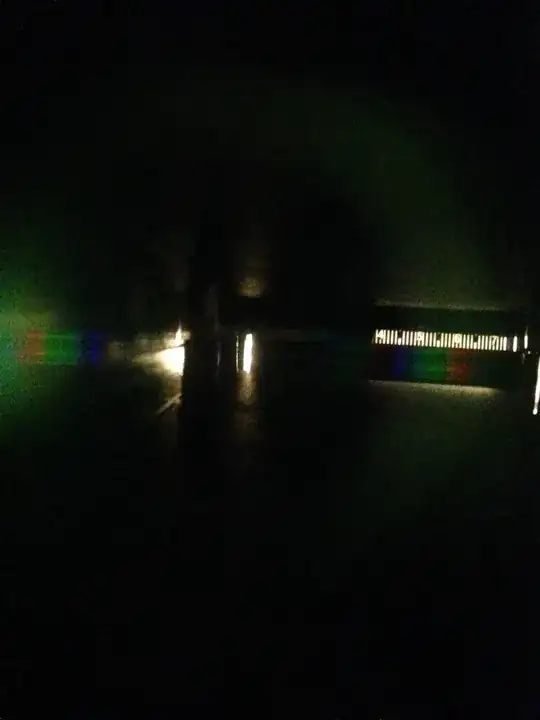

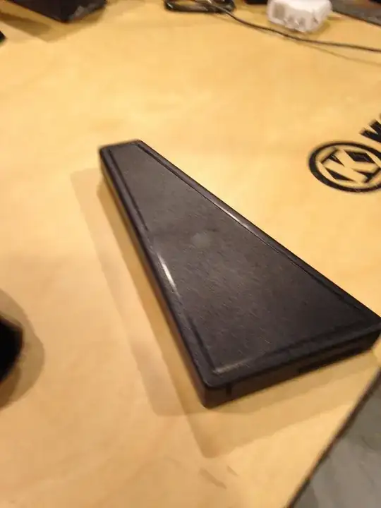

There are several ways. I would say the spectroscope is the easiest. They are about 7 dollars. Here's a photo of one. I took a pic of what you'll see inside too.enter image description hereenter image description here The numbers represent hundreds of nanometers, so a color that is under a 5 would have a wavelength of 500 nm. The photo doesn't quit represent the actual image. If you point the scope at your LED you can read its wavelength. Once you have the wavelength you can then calculate the frequency.
