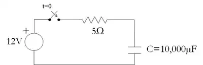

For a simple RC circuit like below, the switch will be closed at time t=0 and the cap is initially uncharged.
The time constant, τ, is RC = 0.05 seconds. So, within 5 time constants (0.25 seconds) the transient is substantially over. The performance equations for this circuit are shown below. $$ i(t) = \frac{V}{R} e^{\frac{-t}{RC}} $$ $$ V_C(t) = V(1-e^{\frac{-t}{RC}}) $$
With V = 12 volts, R = 5 ohms, and C = 10,000µF we can find the energy delivered to the resistor and to the capacitor (they sum to the energy delivered by the battery) in this specific case.
The capacitor will end up asymptotically approaching 12V so it will eventually store in it's electric field the following energy: $$U = \frac{1}{2}CV^2 = 0.72 J$$
The resistor will dissipate i-squared-r power (as R.W. Bird points out): $$i(t)^2*R = \frac{144}{5}e^{-40t} $$ Which when integrated will give us the total energy dissipated in the resistor: $$U_R = \int_0^\infty \frac{144}{5}e^{-40t}dt = 0.72 J$$

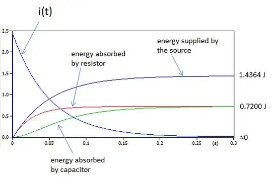

Using a transient simulation tool, ATP via ATPDraw gui, we can plot these transients included the energy delivered to the resistor and to the capacitor. Notice how the resistor (red) and capacitor (green) energy traces merge out just past 5 time constants. Showing that half the energy supplied by the source has been delivered to the resistor (which she dissipates as heat) and the other half is now safely stored in the electric field of the capacitor.

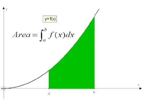

First of all, we know that the area with $x$-axis of the graph of any function $f(x)$ from $x=a$ to $x=b$ is equal to $\int_a^b \! f(x) \, \mathrm{d}x$.
Simmilarly, the area with $x$-axis of the graph of another function $V=f(Q)$ from $Q=0$ to $Q=Q$ is equal to $\int_0^Q \! f(Q) \, \mathrm{d}Q = \int_0^Q \! V \, \mathrm{d}Q$.
area-integration

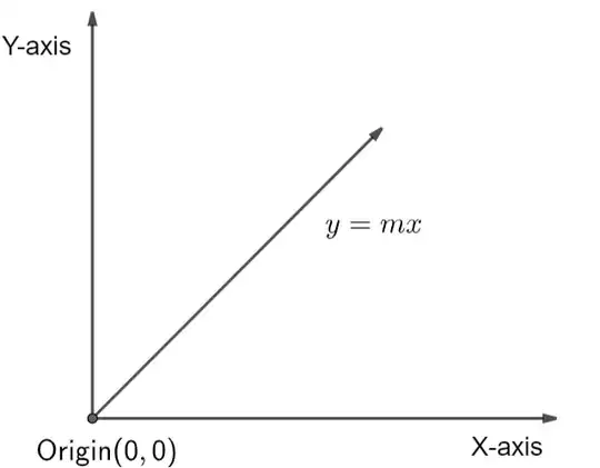

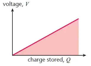

In the case of a capacitor, the Voltage is $0$ at first and it rises as the following equation: $V=\frac{Q}{C}$ until it becomes equal to the voltage of the battery.
The equation can be represented as $y=mx$ (the equation of a straight line intersecting the $(0,0)$ point). Here, $V=y$, $\frac{1}{C}=m$ and $Q=x$.
area-integration
Let us replace $x$ and $y$ with $Q$ and $V$:
area - V vs Q graph of a capacitor
Here the graph generates a triangle with the $x$-axis. The final voltage of the capacitor is equal to the voltage of the battery, $V$.
So, we can easily find out the area of the triangle which is,
$$\frac{1}{2}(Q-0)(V-0) = \frac{1}{2}QV$$ And, it is U. Because, $\int_0^Q \! V \, \mathrm{d}Q = U$ (now you can look at the first 2 lines if you don't understand why it is equal to the Area). Thus, $$U=\frac{1}{2}QV$$ Now, let us discuss the battery.

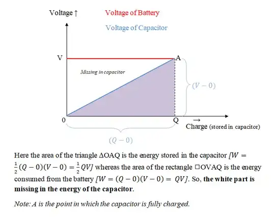

The voltage of the battery remains constant and thus the graph is parallel to the $x$-axis. So, it generates a rectangle with the $x$-axis. Here is the graph of a constant function:
Constant function
And the area will be $\text{length}\times\text{breadth}$.
In our case, it is $(Q-0)\cdot(V-0)=QV$
And it is $W$. Thus, $$W=QV$$
Summary of the answer: We can say that the energy of the capacitor is lower because most of the time, the voltage of the capacitor is lower than the battery (so, the upper left part of the graph is missing in the case of the Capacitor which is present in the Battery).
If you understand nothing from the above writing, look at the image below: enter image description here
But the question is, where is the rest half?
The answer is, the rest half of the energy is converted to heat because of the resistance of the wire.

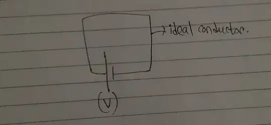

Let's consider a Conductor (ideal) connected between two points having potential difference V.
So, Energy dissipated by the conductor when Q Charge passes through the ideal conductor connected between a potential difference of V Volt must be equal to the Energy supplied by the battery to the conductor which is equal to QV.
(NOTE: In case of Resistance also, the same amount of energy is dissipated. The only difference is that in a Resistance the dissipated energy appears as heat but in this case of an ideal conductor, it appears in some other form (maybe as a spark or Electromagnetic radiation, which I'm not sure)

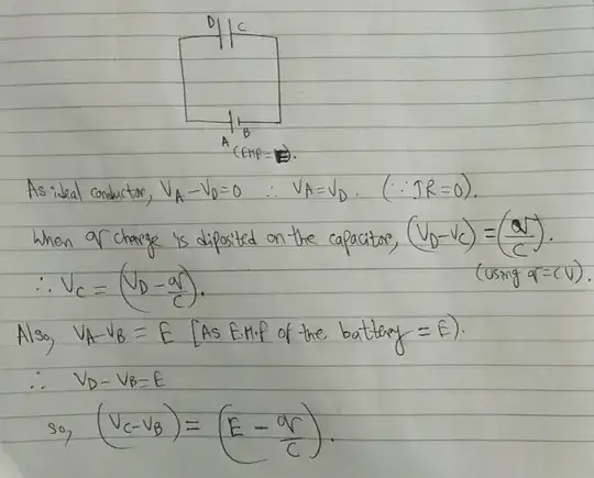

Now let's consider the case of Charging of a Capacitor through ideal Conductor. :
Charging Circuit
Now did you figure out where Energy must be dissipated????
Yess !!! Exactly.. (VC-VB) is a non-zero quantity and hence Potential difference exists across the ideal conductor connected between the points C and B.
Using above discussion :
Calculations
