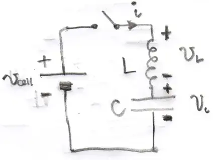

To carry on the spring mass analogy, you need to add an inductor to the electrical circuit.
So you need a circuit with a capacitor which stores energy in an electric field (potential energy) and an inductor which stores energy in a magnetic field ("kinetic energy") as explained here.
Initially the current is zero and the charge on the capacitor is zero.
The switch is closed and although the current is zero the current is changing with the inductor producing an emf $L\frac {di}{dt}$ in opposition to the change.
When current starts to flow the capacitor starts to charge and develop a potential difference across it $\frac q C$.
Allying Kirchhoff's voltage rule for the circuit gives
$$L \frac {di}{dt} + \frac q C = V_{\rm cell} \Rightarrow L\ddot q + \frac 1 C q = v_{\rm cell} $$
The capacitor continues charging but when the potential difference across the capacitor is $v_{\rm cell}$ there is still a current in the circuit (ie the inductor has a store of energy in its magnetic field) and as the current cannot stop instantaneously the capacitor continues to charge until the voltage across it reaches $2v_{\rm cell}$ when the current becomes zero.
It is at this point that if you opened the switch all the energy delivered by the cell is now stored in the electric field of the capacitor.
Carrying on there would be an oscillation of the voltage across capacitor between $0$ and $2v_{\rm cell}$ about a voltage of $v_{\rm cell}$ as shown in the output of a simulation with the cell voltage being $1\,\rm V$. Please note that this simulation did not work for me when using Firefox under Windows 10 but did work with Edge.
The period of the oscillation is $2\pi\sqrt{LC}$.
