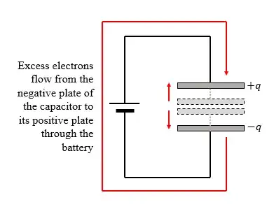

When the plates of a parallel plate capacitor are pulled apart while battery remains connected, the potential difference between the plates remains equal to that of the EMF of the battery as the plates are connected to the terminals of the battery through conducting wires. The battery gets charged during this process. Heat is not liberated when there is no resistance in the circuit, but in the presence of resistance some amount of heat is liberated as discussed in the answer above.
Now lets focus on the question "Why does the battery absorb energy in the first place?". When the plates of the capacitor are pulled apart, its capacitance or the ability to store charge decreases and so the magnitude of charge on either plates reduces. So as we gradually increase the separation between the plates, excess charge on one plate slowly moves to the other plate through the battery as given below:
It can be seen that electrons go from the negative terminal of the battery to its positive terminal. Usually, battery gets discharged when electrons move from the positive terminal to the negative terminal. And here, the case is opposite, and since electrons go from the negative to the positive terminal, the battery gets charged. Further, when the plates are pulled slowly, the energy stored in the battery increases as a cause of decrease in the energy stored in the electric field and the work done by the external agent. Also the electrons move very slowly. In the case of charging a capacitor, the electrons gain velocity in the process and energy is lost as heat as a result of dampening of electron flow oscillations as described in this answer.
On the whole, the following equation gives a good idea of how is energy stored and how much of it is stored (in parenthesis) in the process described in the question:
$$\text{Energy stored in the electric field before separation} \ (U) + \text{Work done by the external agent in pulling the plates} \ (U/2) = \text{Energy stored in the electric field after separation} \ (U/2)+ \text{Energy absorbed by the battery} \ (U)$$
