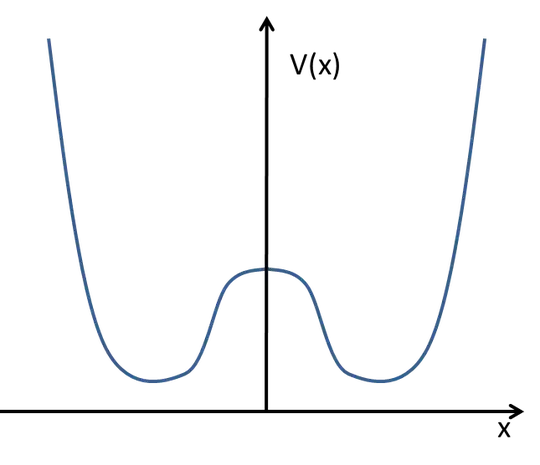

Suppose you want to analyze the stationary behavior of a particle in a potential well that is symmetric with respect to $x=0$ (picture below). In order to simplify your calculation, you could use as a boundary condition that $\frac{\partial \psi(x)}{\partial x}=0$ and solve the Schroedinger equation for x>0 only. This boundary condition then just reflects the symmetric nature of the problem. On top of that, it is equivalent to requiring that the expectation value for the impulse is $0$ in $x=0$, which is what you expect of a stationary solution for a symmetric potential well. You can also extend this to the non-stationary Schroedinger equations with symmetric potential well and symmetric initial conditions, i.e. $\Psi(x,t=0)$ is symmetric around $x=0$.
So, the 'label' you could use is 'plane of symmetry for potential function'. enter image description here
