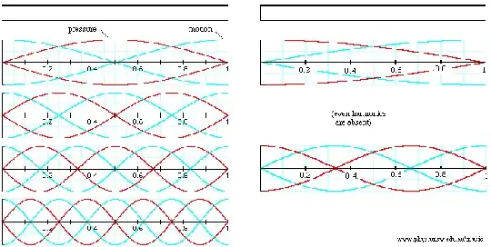

The Neumann boundary condition is rarely relevant on drums or other membrane-based instruments, since it implies the membrane is not tightly fixed to the frame, which makes it very hard to produce a meaningful sound on that instrument. The same argument also goes for stringed instruments.
More commonly it's used to describe wind instruments, where it signifies that the end is open and that the mean displacement of air particles on that end during tone production is at a local maximum, i.e. $\partial_x \psi(0,t)=\partial_x \psi(L,t)=0$, as illustrated in the picture below (taken from here), which is exactly the Neumann boundary condition, as opposed to the Dirichlet condition which is equivalent to a closed pipe end.
This, of course, is only illustrated in the case of one dimension, but similar reasoning applies to the more general 3D case. Also, a similar picture holds for membrane instruments, but, as I said, they are mainly bound by the Dirichlet condition, so my answer focuses on wind instruments.
