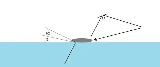

This picture shows the vectors; the water support force, kinetic energy of stone coming and the energy after skip.
So, you need to have a flat stone, which has a small weight compared to the collision surface area, and it must be thrown in an angle (stone surface compared to water) which is optimally 2x (theoretical max, practical 1.8) the optimal angle of collision defined the weight/surface ratio.

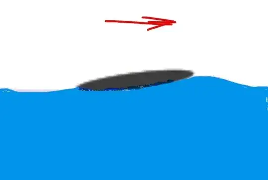

Stone has an angle of attack, so when stone moves in water, because water has inertia, and stone moves in order to make water move, so the pressure of water increases. When this pressure increases to a certain height, the water surface under the stone is equivalent to a slope (the slope of water). Because of the inertia of the stone, the stone moves upward along this slope. And finally out of the water. After leaving the water, there is no slope. Under the action of gravity, the stone will eventually fall back to the water. Therefore, after proper improvement, the lift formula of the wing can be used to describe the movement of rocks on the water surface.
