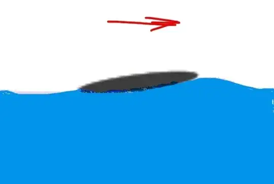

The rock has an angle of attack, so the water at the bottom of the stone changes from static to downward flow, so the pressure of the water increases. So the water has a lift on the stone. The lift makes the stone move upward. After moving for a period of time, the stone leaves the water. After moving in the air for a period of time, under the action of gravity, the stone falls back to the water. Because the stone has an angle of attack, so the bottom of the stone has a lift, so after a period of time the stone left the water again...
