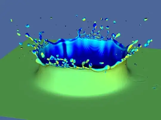

meteor splashes
(source: zaleski at www.lmm.jussieu.fr)
(Note: sometimes the impact of a meteorite is referred to as splashing, if small bits of ejecta are formed.)

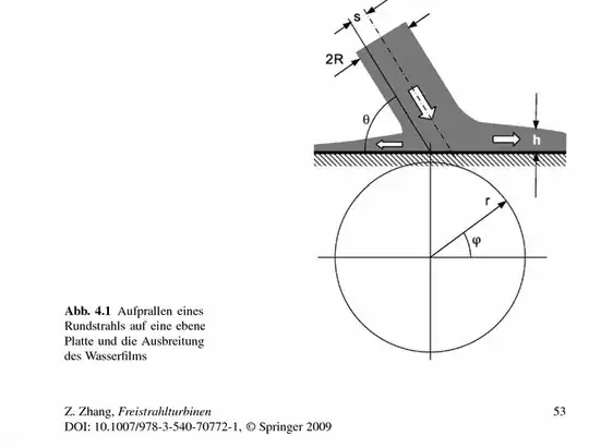

There is a study from "Hasson and Peck", 1964, which explains "Thickness distribution in a sheet formed by impinging jets." It's all basically Bernoulli's equation; "Velocity -> pressure -> velocity" and then simply continuity.
Shortly, With ideal fluid the Kinetic energy can be completly maintained, though there is obviously more or less 90-degree change in direction. Anouther good source is the Book "Zhang, Zhengji, Freistrahlturbinen" You can luckily preview these particular pages (53-54) here; http://www.springer.com/us/book/9783540707714 It's german, but the equations and a picture is there.
