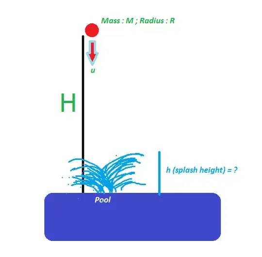

Suppose from a height $H$, I throw a ball of mass $M$ and radius $R$ with initial velocity $u$ into a pool of depth $x$ having a liquid with density $\rho$ and coefficient of viscosity $\eta$.
Upto what height will the Water Splash?
This may be a silly question! (Source : my brain)
Assume every condition to be identical with no air resistance.
Feel free to assume any other parameters if needed.
P.S. $\rightarrow$ I've see similar questions but some of them want an exact answer and some are not so direct while some are incomplete questions...
Small Note : We do not have to consider the highest 'single' drop... Just assuming almost every water droplet jumped upto a height $h$. Ideal conditions...
Feel free to assume the liquid as WATER if required!
