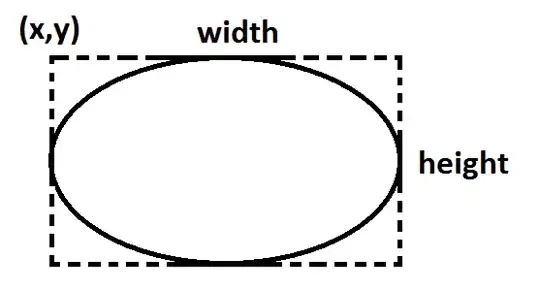

I think that the easiest way to understand this is in the formula for addition. If you consider your quantity $C$ which depends on $A$ and $B$ such that $C=A+B$, then the formula $\Delta C = \Delta A + \Delta B$ overestimates the error values. You can visualize this as a rectangle with $A$ on the x-axis and $B$ on the y-axis with the area enclosed being $\Delta C$. However, the likelihood of having errors in the corners, i.e. the extreme values for both $A$ and $B$ are very small. Therefore, instead of using a rectangle to represent the error, we instead use an ellipse with $\Delta C^2 = \Delta A^2 + \Delta B^2$. This gets rid of the extremely unlikely error values.
