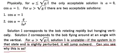

Here's the claim the textbook makes (note 1: "g" represents the local gravitational acceleration; note 2: the term "solution" is with respect to the task of finding the angle alpha):
conical pendulum, jumping outward

Here's a link to a screenshot of the textbook page talking about this conical pendulum in detail and the phenomenon I'm asking about:
https://i.sstatic.net/ALJ08.png

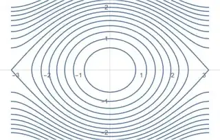

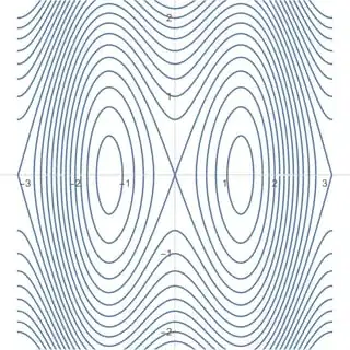

The analysis is supported by looking at level curves of $H$ (it is conserved, even if it is not the total energy).
Below the critical frequency we have the normal phase curves of a harmonic oscillator with stable fixed point at the origin and unstable in the inverted position.
Above the critical frequency, the stable fixed point at $\theta_0$ is clearly visible, as is the unstable fixed point at the origin.

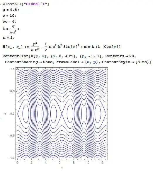

The Hamiltonian of this system, as given by @ZeroTheHero, is $$H(\theta,p)=\frac{p^2}{ml^2}-\frac{1}{2}m\omega^2l^2sin^2\theta+mgl(1-cos\theta)$$ The process how to determine the system stays stable or not qualitatively is that write down the fixed ponts or critical points firstly and then substitute these points into Eigenvalues of the coefficient matrix of the system and finally the behavior of the system will be determined depending on the attribute of Eigenvalues.
The fixed ponts or critical points are given by $$(\frac{\partial H}{\partial p},-\frac{\partial H}{\partial \theta})=(0,0)$$ which corresponds to two equations $$\frac{2p}{ml^2}=0,\quad -mglsin\theta+m\omega^2l^2cos\theta sin\theta=0$$ The first set of solutions is $$(\theta_0,p_0)=(k\pi,0),\quad with\quad k\in Z$$ and if $\theta\neq k\pi$, we obtain the second set of solutions $$(\theta_0,p_0)=(arccos\frac{g/l}{\omega^2},0)$$ The coefficient matrix of the system is $$ M=\begin{bmatrix} \frac{\partial^2H}{\partial p\partial\theta}&\frac{\partial^2H}{\partial^2 p}\\ -\frac{\partial^2H}{\partial^2 \theta}&-\frac{\partial^2H}{\partial\theta\partial p} \end{bmatrix}=\begin{bmatrix} 0&\frac{2}{ml^2}\\ -mglcos\theta+m\omega^2l^2cos2\theta&0 \end{bmatrix}$$ The Eigenvalues are $$\lambda_1=-\sqrt{2}\sqrt{-\omega_c^2cos\theta+\omega^2cos2\theta},\quad\lambda_2=-\lambda_1$$ in which $\omega_c^2=\frac{g}{l}$.
Case1. investigating the first set of fixed points $(\theta_0,p_0)=(k\pi,0),\quad with\quad k\in Z$:
The corresponding Eigenvalues are $\lambda_1=-\sqrt{2}\sqrt{-\omega_c^2(-1)^k+\omega^2}=-\lambda_2$
  1. If $k=2n,n\in Z$, then $\lambda_1=-\sqrt{2}\sqrt{-\omega_c^2+\omega^2}$
    1. If $\omega>\omega_c$, then $\lambda_1=-\lambda_2\in R$, the fixed point is a saddle (unstable).
    2. If $\omega<\omega_c$, then $\lambda_1=-\lambda_2\in C$, the fixed point is a center (stable).
  2. if $k=2n+1,n\in Z$, then $\lambda_1=-\sqrt{2}\sqrt{\omega_c^2+\omega^2}$, which is always a $Real$ number, so the fixed point is a saddle (unstable).
Case2. investigating the second set of fixed points $(\theta_0,p_0)=(arccos\frac{g/l}{\omega^2},0)$:
The corresponding Eigenvalues are $\lambda_1=-\sqrt{2}\omega\sqrt{\frac{\omega_c^4}{\omega^4}-1}=-\lambda_2$
  1. If $\omega>\omega_c$, then $\lambda_1=-\lambda_2\in C$, the fixed point is a center (stable).
  2. If $\omega<\omega_c$, then $\lambda_1=-\lambda_2\in R$, the fixed point is a saddle (unstable).
Conclusion: if $\omega>\omega_c$, only $(\theta,p)=(n\pi,0),n\in Z$ is the unstable fixed point; and if $\omega<\omega_c$, only $(\theta,p)=(2n\pi,0),n\in Z$ is the stable fixed point; enter image description here
