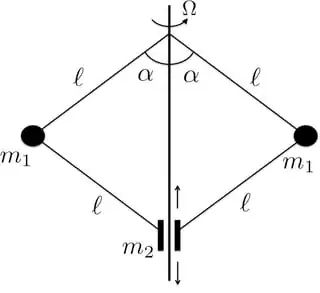

An example for which this applies is the flyball governor. The Lagrangian for the system is $$ L=\ell^2(m_1+2m_2\sin^2\alpha)\dot{\alpha}^2+ m_1\ell^2\Omega^2\sin^2\alpha +2(m_1+m_2)g\ell\cos\alpha\, . $$ and it is difficult to identify a "potential" $V(\alpha)$ since the coefficient of term in $\dot{\alpha}^2$ is actually a function of $\alpha$.
The momentum $p_\alpha=\partial L/\partial \dot{\alpha}=2\ell^2(m_1+2m_2\sin^2\alpha)\dot{\alpha}$, so the Hamiltonian is found, after straightforward manipulations, to be \begin{align} H&= \frac{p^2_\alpha}{4\ell^2(m_1+2m_2\sin^2\alpha)}-m_1\ell^2\sin^2\alpha\,\Omega^2 -2(m_1+m_2)g\ell\cos\alpha\, . \end{align}
The fixed points are easily obtained. Clearly $\partial H/\partial p_\alpha=0$ implies $p_\alpha=0$. On the other hand: $$ \frac{\partial H}{\partial \alpha}\vert_{p=0}= 2\ell\sin(\alpha)\left(m_1\ell \cos(\alpha)\Omega^2-(m_1+m_2)g\right)=0\, , $$ which gives $\alpha=0$ but also a non-trivial equilibrium point if one can satisfy $m_1\ell \cos(\alpha_0)\Omega^2-(m_1+m_2)g=0$ for some angle $\alpha_0$. See here for another example.
