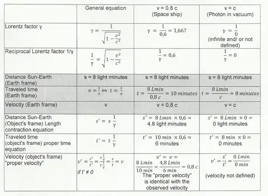

There is one unexplored zone in special relativity which seems to yield only meaningless results. When particles are moving not only near speed of light (v < c) but at speed of light (v=c), the Lorentz transforms cease to operate. The proper time is reduced mathematically to zero, but there is no reference system from which this could be observed. Also, lengths would be reduced to zero for such a hypothetical non-existent reference system.
As a consequence, up to now the corresponding equations deriving from special relativity (time dilation and length contraction) were simply confined to massive particles, excluding the case v=c from the domain of definition of these equations. There is no physical legitimation for such a break in their application (implying de facto a limitation of universal validity of special relativity), and Einstein's special relativity does not cease to exist at v=c as it is shown by the means of an example in the following chart:
By consequence, it follows from the equations for proper time and length contraction that a photon which is traveling the distance Sun-Earth according to our observations in t=8 minutes for a distance of s=8 light minutes, has from its (hypothetical) own point of view a proper time t'=0 and travels a distance s'= 0.
If time and traveled distance are both zero that would mean that there was no movement. When I am traveling zero meters in zero seconds, I did not move, and there is no movement which could be subject to a measurement of velocity. My velocity is not defined (0m/ 0 sec.)

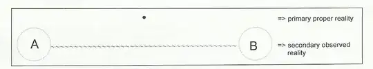

The Lorentz factor is assigning to photons two realities, that means, the transmission of the light momentum is double-tracked:
The secondary reality is the (commonly known) observed reality: Maxwell equations are describing a light quantum in the form of an electromagnetic wave moving at speed of light (v = c, t = 8 min, s = 8 light minutes). The transmission of the momentum occurs indirectly from Sun to the wave and then from the wave to Earth.
The primary reality is the unobserved proper reality of the photon: t'=0 and s'=0, proper time and distance are zero, there is no velocity. That means that the momentum is transmitted directly outside of spacetime from Sun to Earth, without intermediate medium.
