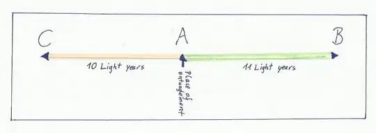

When two entangled particles are measured in an EPR experiment, we consider these events as non-local. Generally I agree. But does this also apply to a pair of photons in vacuum? (and if so, why?)

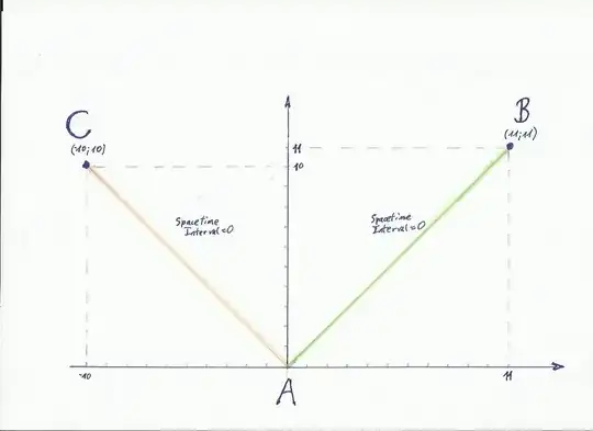

enter image description here From the point of view of any observer's Minkowski diagram, the two spacetime intervals of the lightlike worldlines of the two photons AB and AC are always zero (so-called "empty intervals"), and by consequence, B and C are located in the "immediate surroundings" of A, and the events should not be nonlocal.

But first of all we might investigate whether events A and B are "in the "immediate surroundings" of each other", for instance (or similarly: events A and C).
The sketches clearly suggest that events A and B are distinct events. (Which does not contradict the magnitude $s[ A, B ] = 0$. This property of "null intervals" is certainly different from null vectors in the arguably more usual sense of preserving identity when being added to any other vector.)
Event B is "on the future light-cone of" event A. (And event C is "on the future light cone of" event A as well.) In some sense it may therefore be said that in some sense event B "was influenced first hand by" event A (and that event C "was influenced first hand by" event A, too).
But, as both sketches suggest, we should not merely consider the events A, B and C themselves but the geometric relations between photon source (which took part in event A) and the two (separate) detectors (one of which took part in event B, but not in event C; and the other detector vice versa).
Presumably the source and the two detectors were and remained at rest to each other throughout the experiment; accordingly their configutation is characterized by the indicated (non-zero!) distance values. Surely it cannot be said that the source and the detector which took part in event B had been "in the "immediate surroundings" of each other"; neither could be said that the source and the detector which took part in event C had been "in the "immediate surroundings" of each other"; nor that the two detectors had been "in the "immediate surroundings" of each other".
Finally looking again at the relation between events B and C it can be said that
  • they're distinct,
  • they're spacelike separated, with interval magnitude $\sqrt{ 440 } ~ \text{light years}$, and
  • the principal identifiable participants of the described experimental setup who took part in one or the other of these two events (namely the two detectors) were at rest to each other, throughout the experiment, at a distance of $ 21 ~ \text{light years}$.
These three characterizations are mutually consistent; and either one would seem to indicate that events B and C should not be called "in the "immediate surroundings" of each other".

In your diagram, the spacetime interval between B and C is $(x_c-x_b)^2-(t_c-t_b)^2 = 21^2-1^2= 440$. So $B$ is not in the immediate surroundings of $C$, there is a spacelike interval between them. Also, the EPR experiment has an entirely local explanation, see:

In your example, the distance between $B$ and $C$ is spacelike, so they cannot influence another according to the principle of locality. However, they are both be influenced by event $A$, because $A$ is on the backwards light cone of both $B$ and $C$.

  3. you are correct where you say "B and C are located in the "immediate surroundings" of A" ONLY if you take it in spacetime, in 4D. The four-vektor and the universe is set up so that the spacetime distance of A,B,C will stay constant 0.

Now let's talk about non-locality and your questions in n° 4. "EPR experiments are currently considered to be non-local" OK you are right where you say that most of the EPR experiments are ACCEPTED by QM theories to be non-local, but only in space (3D). In spacetime (4D) it is different. According to SR, the line that you drew, with "spacetime interval=0" is exactly what SR says, for particles with zero rest-mass, it must be 0 so you are correct, there is no need for the word "interval".
The reason for that is what SR says about photons, they are traveling at speed c in space (3D), but their speed in the time dimension is 0. That is why that is a 45degree line and why on that line as you move, your spacetime interval is constant 0. You are not moving in the time dimension if you move on that line, that is, if you travel at the speed of light, but that is only possible if you have zero rest-mass like a photon.
