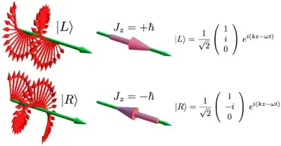

Left and right handed circular polarization, and their associate angular momenta.
Please note that the individual photons have spin either along or against their direction of motion, while the electric fields are perpendicular. These are built up non-trivially, it is the handedness of the electric field vector ( which defines polarization classically) as it progresses in space and time that connects the electric fields to the spin direction.

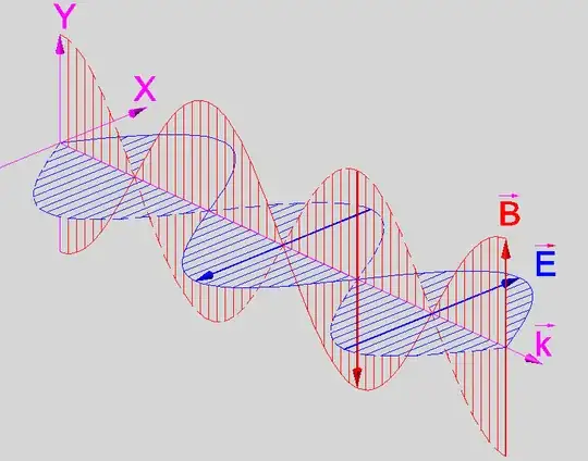

The polarization of photons is carried out by the same orientation of the magnetic and electric component of the EM field.
In order to understand the spin, you have to bear in mind that the electric and the magnetic components are dipols and have a direction. Let one see in the direction of photon's movement on the two vectors representing the electric and the magnetic field so there are exactly two possible states. Say, the electric field vector is oriented horizontally, then the vector of the magnetic field can be oriented up or down.
