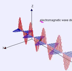

So reading Fundamentals of Light Microscopy and electronic imaging by Douglas&Murphy, at one point the author mentions that light can be described as electromagnetic waves and then gives a picture similar to this one
http://en.wikipedia.org/wiki/Electromagnetic_radiation#mediaviewer/File:Electromagneticwave3D.gif.

My confusion stems from the paragraph when the author describes polarized light. In the general form of the waves, given in the picture, the electric field vectors are parallel. So, all light should be polarized, right?
Also, regarding the image describing the waves, does the pink arrow(which is a straight line), which is parallel to the x-axis(Am I right?) describe the path of a photon?

The only requirement for light is that the electric field must be perpendicular to the magnetic field at any given point in time or space. This assumption arises naturally from Maxwell's equations.
The most intuitive way of thinking about light is with the picture you included of the light wave. However, you have to imagine an infinite number of light waves like the one pictured happening everywhere simultaneously. For simplicity just multiply your picture by several times and imagine several light waves travelling parallel to one other. If the electric field for all of the light waves is oriented in the same direction, you get something that looks like linearly polarized light.
However, since light is a wave, you can add together the electric and magnetic fields of all of these waves. You can create circular or elliptical of light by phase shifting axis of the electric field.
When physicists talk about about "unpolarized" light, they mean that the light is too unorganized to constitute using the word polarization. Imagine the same picture of several light waves travelling in parallel, but with the direction of the electric field for each wave randomly oriented. The sum of all the electric fields for all these waves would have a direction, but it would change very quickly due to random changes in the emission of your source light.

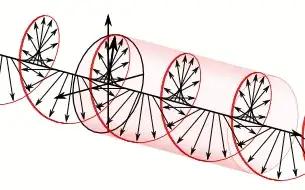

The book is imprecise because there are other types of polarized light. Now, consider a point in the path of the wave, like the green point in animation you mentioned. In that image, the light is linearly polarized so the electric field draws a line at the location of the point. However, there is also circularly polarized light where the electric field draws a circle as in this picture enter image description here
Then, light is said to be polarized if the electric field at a given point draws a line, a circle, or in general, an ellipse. Unpolarized light occurs when you have many of these waves superimposed, which, results in an electric field that oscillates randomly in all directions.

The picture of the wave you are looking at is already polarized and that is plane polarized light. But this is not the general case, waves emitted by any one molecule may be linearly polarized but an ordinary light source contains large number of molecules with random orientations,so the emitted light is random mixture of waves linearly polarized in all possible transverse directions. so light from ordinary light source is unpolarized.

(About the pink line, it shows indeed the direction of propagation, but the text is truncated.)
