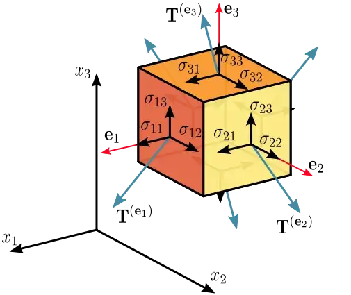

22
For each surface on a unit cube (see below), the stress on that surface can point in each of the three directions.
enter image description here (source)
Since it is not necessarily the case that $\sigma_{11}=\sigma_{31}=\sigma_{21}$ (all pointing the in the same $\mathbf{e}_1$ direction)--or any of the other $\sigma_{ij}$ combinations, we need to have 9 components describing it, hence the tensor being the natural choice: $$ \boldsymbol\sigma=\sigma_{ij}=\left(\begin{array}{ccc}\sigma_{11}&\sigma_{12}&\sigma_{13}\\ \sigma_{21}&\sigma_{22}&\sigma_{23}\\ \sigma_{31}&\sigma_{32}&\sigma_{33}\end{array}\right) $$
Since pressure acts on all sides equally, it can be naturally described as a scalar quantity and is related to the stress tensor with a Kronecker delta, $\delta_{ij}$, under hydrostatic equilibrium conditions: $$ \sigma_{ij}=-p\delta_{ij} $$

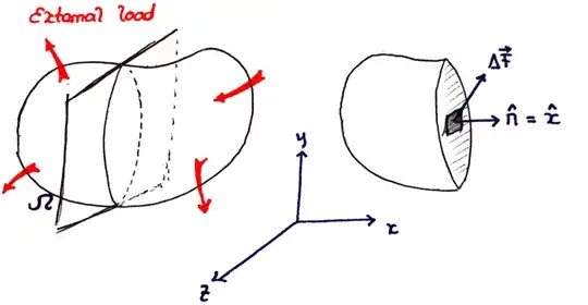

Imagine you have a body $\Omega$ and you want to understand how it responds to some external load.
Do do this, imagine you cut the body with a plane, say the plane whose normal vector is the $\hat{x}$ vector. Now select an element of area $\delta A$ and measure how the force on the element, I will call it ${\rm d}\vect{F}$.
Define the numbers
$$ \tau_{xx} = \lim_{\Delta A \to 0}\frac{\Delta F_x}{\Delta A}, ~~~ \tau_{yx} = \lim_{\Delta A \to 0}\frac{\Delta F_y}{\Delta A}, ~~~ \tau_{zx} = \lim_{\Delta A \to 0}\frac{\Delta F_z}{\Delta A} $$
You can see that
  • It is important to label this element with out choice of the orientation for the cutting plane. In this case we select $\hat{x}$, but in general it could be any normal vector $\vect{n}$
  • The definition of $\tau$ resembles that of pressure. Indeed, if you consider the element $\tau_{xx}$ you'd get the force per unit area perpendicular to the are element along the $x$ direction.
The stress tensor is just the collection
$$ \tau = \left(\begin{array}{ccc} \tau_{xx} & \tau_{yx} & \tau_{zx} \\ \tau_{xy} & \tau_{yy} & \tau_{zy} \\ \tau_{xz} & \tau_{yz} & \tau_{zz} \\ \end{array}\right) $$
The average pressure could then be defined as
$$ \pi = \frac{1}{3}(\tau_{xx} + \tau_{yy} + \tau_{zz}) $$
