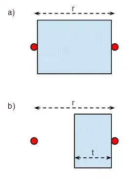

A dielectric effectively behaves as if it was thicker than it is. If the dielectric constant is $K$ and the thickness of the dielectric is $t$, then for calculating the force it behaves as if the thickness was $t\sqrt{K}$.
To see this let's take the example we know about where the dielectric fills the space between the charges:
Force
In (a) the thickness of the dielectric is the same as the distance between the charges, $r$, so the effective thickness is $r\sqrt{K}$. If we put this in the force law we get:
$$ F = \frac{1}{4\pi\epsilon_0}\frac{Q_1Q_2}{(r\sqrt{K})^2} = \frac{1}{4\pi\epsilon_0}\frac{1}{K}\frac{Q_1Q_2}{r^2} $$
as we expect. The force is reduced by a factor of $K$.
Now consider (b). To get the effective distance between the charges we have to add the distance through the air, $r - t$, plus the effective thickness of the dielectric, $t\sqrt{K}$, so the effective distance between the charges is:
$$ d = (r - t) + t\sqrt{K} $$
and the force is just:
$$ F = \frac{1}{4\pi\epsilon_0}\frac{Q_1Q_2}{d^2} = \frac{1}{4\pi\epsilon_0}\frac{Q_1Q_2}{(r - t + t\sqrt{K})^2} $$
This is how you get the force when the space between the charges is only partially filled by the dielectric.

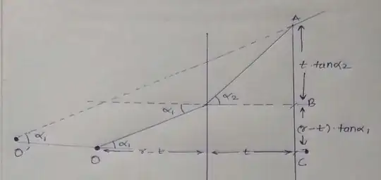

Boundary conditions on a dielectric are generally very complicated. While general ideas about how polarization works and affects the overall field can be talked about, the specifics of even simple cases can be too complicated to attempt properly.
So what is the deal with electric field near dielectrics?
Well to begin with I hope you have some general idea about field $\overrightarrow{D}$ (known as electric displacement vector) which is given by: $$\overrightarrow{D}=\epsilon\epsilon_0\overrightarrow{E} + \overrightarrow{P}$$
Where P is the polarization vector which gives the general idea of dipole moment per unit volume of a dielectric. It has some special properties like its polarization density and relation with Gauss' law which make it useful to define.
Ok that's great, but why is D defined in such an arbitrary manner?
That's because combining the gauss law for P and E gives us a special property for the value
$$\oint(\epsilon\epsilon_0\overrightarrow{E}+\overrightarrow{P})\cdot \mathrm d\textbf{A}=q_\mathrm{free}$$
Where $q_\mathrm{free}$ is the free charges that have not originated due to polarization of the dielectric.Generally it is easier to deal with D and free charges than E and total charge.
How are these concepts important for the problem on hand?
$$\oint{\textbf{E}\cdot \mathrm d\textbf{l}}=0$$
$$\oint{\textbf{D}\cdot \mathrm d\textbf{A}}=q_{free}$$
These equations help us determine the boundary conditions for E and D near the boundaries of dielectrics, here vacuum helps making our calculation easier. This gives us a law reminiscent of Snell's law.
$$\frac{\tan\alpha_2}{\tan\alpha_1}=\frac{\epsilon_2}{\epsilon_1}$$
Solving the problem at hand
Now the more difficult part. Solving these cases would be complicated even with the new tools in our arsenal. We have 2 charges whose effect on the dielectric would vary the overall polarization of the slab. However, if we take an assumption that $q_1>>q_2$ this would help us solve the question without too much complication. This is because it lets us ignore the negligible polarization due to $q_2$ compared to $q_1$. (I couldn't solve the actual problem without this restriction but this may help.)
\begin{align} \mathrm{O'C} &= \frac{\mathrm{AC}}{\tan \alpha_1} \\ &= \frac{(r-t)\tan \alpha_1 + t\tan \alpha_2}{\tan \alpha_1} \\ &= r - t + kt \\ &= r + (k-1)t \\ \end{align}
This derivation will give you the apparent distance between the 2 charges and hence the electric field of $q_1$ on $q_2$ (Please take care to remember the assumption $q_1 >> q_2$.)
