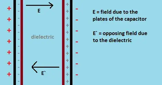

We'll use an example to understand. Consider a circular parallel-plate capacitor with a dielectric as shown in the figure.
Assume that there is no gap between the dielectric and the plates of the capacitor. The gap seen in the picture is for visual aid only.
Let the charge on the capacitor plates be $q$. This charge will induce a charge $q`$. The induced charges are such that the electric field created by the induced charges opposes the electric field due to the capacitor plates.
Consider a Gaussian surface as shown in the figure (blue color cylinder). We will apply Gauss' law in a unique way: neglect effects of the dielectric. Using this way, we will consider the effect of polarization of the dielectric which would have otherwise been neglected if Gauss' Law was applied with the correct constant ($\epsilon$ instead of $\epsilon_0$)
$$\oint E.ds = \frac{q - q`}{\epsilon_0} \tag{2}$$
The electric field due to the capacitor's plates is given by:
$$E = \frac{\sigma}{\epsilon_0} = \frac{1}{\epsilon_0} \frac{q}{A}$$
The electric field due to the dielectric is given by:
$$E` = \frac{\sigma`}{\epsilon_0} = -\frac{1}{\epsilon_0} \frac{q`}{A}$$
The net electric field setup inside the dielectric is given by:
$$E_{net} = E + E` = \frac{1}{\epsilon_0} \frac{q - q`}{A} \tag{3}$$
Let us introduce a new quantity $\epsilon_r$ and define it as follows:
$$E_{net} = \frac{E}{\epsilon_r} = \frac{q}{A\epsilon_0 \epsilon_r} \tag{4}$$
Substituting $E_{net}$ using $(3)$ in $(4)$, you get:
$$\frac{1}{\epsilon_0} \frac{q - q`}{A} = \frac{q}{A\epsilon_0 \epsilon_r}$$
Solving for $q`$, you get:
$$q` = q\left(1 - \frac{1}{\epsilon_r}\right) \tag{5}$$
Substituting $(5)$ in $(2)$, you get:
$$\oint E.ds = \frac{q}{\epsilon_0 \epsilon_r} \tag{6}$$
Whoa! The equation $(6)$ is the Gauss' Law in its general form. The change in electric flux in the presence is caused by the induced charges in the dielectric.
