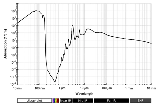

Water is not transparent for deepUV and infrared. From the evolutionary point of view our eye developed to see electromagnetic radiation present at earth in the past (and now) - deep UV and infrared are absorbed by water vapor and other gasses in atmosphere - so there were nothing to see at these wavelengths.
Here is a nice explanation on why some things are transparent and some are not : http://en.wikipedia.org/wiki/Transparency_and_translucency#Transparency_in_insulators
Basically water is dielectric - and majority of pure dielectrics are transparent.
Water absorption spectra
http://en.wikipedia.org/wiki/Electromagnetic_absorption_by_water
BarsMonster

So, BarsMonster's excellent graph shows us where in the spectrum water's internal mechanics tends to absorb photons for good (thus where it is opaque) and where it behaves as a dielectric, simply delaying the light through absorption and re-emission. In a short answer, it is impossible to explain the whys and wherefores of the graph as its peaks and troughs are owing to molecular resonances of very high complexity. The graph is really as good a simple summary as one is going to get.
