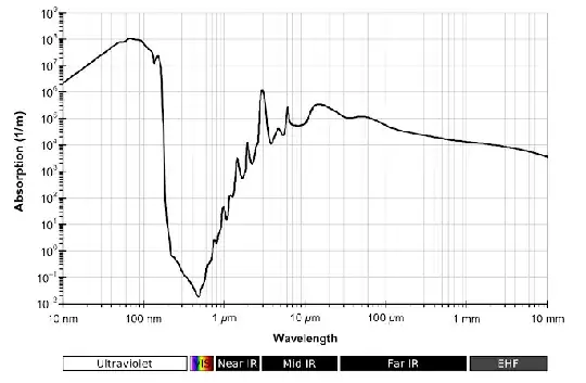

Ions in water are much less mobile than electrons in a metal. To have an effect on EM wave propagation, the charges in a material must be able to rearrange quickly enough to affect the propagating electromagnetic wave. The ions in water are too heavy and too much impeded by the surrounding water to do so for light. However, for longer wavelengths, water with dissolved ions is indeed opaque. That is why submarines cannot communicate using radio waves when submerged (only broadly speaking, they can if very close to the surface or if using extremely long wavelengths a bit deeper)
