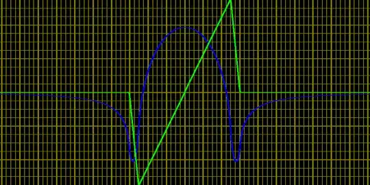

These relationships arise owing to stability considerations (see footnote) and mean that the refractive index as a function of wavelength/frequency is not independent of the absorption as a function of frequency. So, losses described by the Fresnel equations aside, there is no relationship between refractive index and transparency at a single wavelength, but there is an integral transform relationship between the two as functions of frequency - to within a constant. The Kramers-Kronig relationships show that, given the refractive index or absorption as a function of wavelength for all wavelengths, one can work out the other to within a constant.
Notice that they mix the refractive indices over the whole frequency range to compute the value of $\alpha$. So, for their accurate application, the KK relationships require that we know $n(\omega)$ over the whole range of frequencies where they are nonzero.
Below is shown a typical result of the above equations. The green curve shows a triangular absorption as a function of frequency, with frequency along the horizontal axis (actually, it is gain in a Raman amplifier, but the same principle applies). The phase of the amplifier, proportional to an effective refractive index for our purposes, is the blue curve. I emphasize yet again that the KK relationships only determine absorption / refractive index to within an arbitrary additive constant, so that's why the blue curve has both positive and negative values - it can be added to any constant refractive index and still be valid. This arbitrary constant is also why a single refractive index says nothing about absorption.
