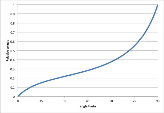

Quick sanity check: when $\theta$ is close to $0$, there is little torque; the denominator would become zero when $3\sin\theta\cos\theta = -1$ - but that doesn't happen when $\theta\in[0,\pi/2]$ which is reassuring. In fact the plot of torque looks like this: enter image description here
It's possible I made a mistake in the above, but it looks reasonable. The approach should be correct...

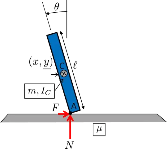

If the body is in contact with the ground like this pic
then the equations of motion are
$$ \begin{aligned} F & = m \ddot{x}_C \\ N - m g & = m \ddot{y}_C \\ N \frac{\ell}{2} \sin\theta + F \frac{\ell}{2} \cos\theta & = I_C \ddot\theta \end{aligned} $$
with motion constraints
$$ \begin{aligned} \dot{x}_C & = \dot{x}_A - \frac{\ell}{2}\cos\theta \dot\theta & \ddot{x}_C & = \ddot{x}_A - \frac{\ell}{2}\cos\theta \ddot\theta + \frac{\ell}{2}\sin\theta \dot{\theta}^2 \\ \dot{y}_C & = - \frac{\ell}{2}\sin\theta \dot\theta & \ddot{y}_C & = - \frac{\ell}{2}\sin\theta \ddot\theta- \frac{\ell}{2}\cos\theta \dot{\theta}^2 \end{aligned} $$
and contact properties
$$ F = 0 \\ N > 0 $$
The above is solved by
$$ \boxed{ \begin{aligned} \ddot\theta & = \frac{ m \frac{l}{2} \sin\theta \left( g -\frac{l}{2} \dot{\theta}^2 \cos\theta \right)}{I_C + m \left(\frac{l}{2}\right)^2 \sin^2\theta} \\ N & = I_C \frac{ m \left( g -\frac{l}{2} \dot{\theta}^2 \cos\theta \right)}{I_C + m \left(\frac{l}{2}\right)^2 \sin^2\theta} \\ \ddot{x}_C & = 0 \\ \ddot{y}_C & = - \frac{ \frac{\ell}{2} \left( I_C \dot{\theta}^2 \cos\theta + m \frac{\ell}{2} g \sin^2\theta \right)}{I_C + m \left(\frac{l}{2}\right)^2 \sin^2\theta} \\ \end{aligned} } $$
Now the torque about the center of mass is
$$ \begin{aligned} \tau_C & = N \frac{\ell}{2} \sin\theta + F \frac{\ell}{2} \cos\theta \\ & = \frac{\ell}{2} N \sin\theta \\ & = I_C \frac{ m \frac{l}{2} \sin\theta \left( g -\frac{l}{2} \dot{\theta}^2 \cos\theta \right)}{I_C + m \left(\frac{l}{2}\right)^2 \sin^2\theta} \end{aligned} $$
NOTE: The notation $\dot{x}_C$ and $\ddot{x}_C$ means the velocity and acceleration of point C along the x direction. Similarly for the rest of the velocity/acceleration components above. Notice how much more complex this problem is, than you might have originally thought.
