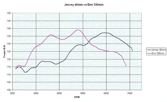

There is an excellent feature written by Dave Walker, an engine tuning guru from the UK. He performs A-B-A tests comparing inlet runner lengths on a 1600cc engine in an amateur racing car.
Here is a link to the report.
...and here is an interesting print out of torque curves, comparing a 40mm length with a (ridiculous, but interesting) 330mm length.

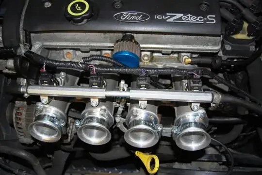

The short inlet runners...
Short inlet runners...

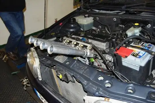

...and the really long ones.
...and the really long ones!
