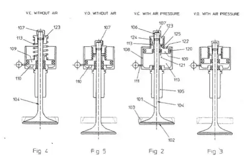

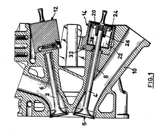

From doing some reading here: http://www.jegs.com/tech-articles/cylinder-heads.html it looks like what you are referring to the size of the values and the amount of lift they get. Here's a couple of pictures that should help.
Basic Valve Configuration
This is the setup for basic overhead cam operation. Here's another, simpler diagram that shows what happens when the valves open and close.
Valves in operation
In this figure you can see that the volume of the valve is proportional to how big around the valve is, and how far the valve is opened. A large valve that only opens a small amount would still have a small volume.
As for how this affects the power curve the more air you get into and out of the engine the more power you generate. There are trade offs though as a really large cross sectional area in the intake path will yield a large volume of air, but at a low velocity. That will provide a lot of power, but only at RPM that are too high for the street. Your throttle response would be sluggish at street level RPMs. The reading at the above link talks about the intake path, including the valve volume, as being tuned for the response you want by getting good velocity and good volume.
All of this is dependent on the engine too since bigger displacement engines need more air, and so different tuning (cross sectional area, length, etc) of the intake and exhaust paths.
I hope that helps!
