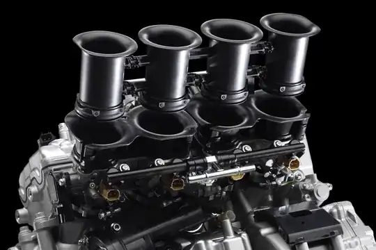

The Yamaha R1 has a very strange intake design. Notice the intake horns in the image below. They sit above the throttle bodies and are not attached directly to them leaving an air gap between the throttle bodies and these horns.
If the full assembly were visible this would all be shrouded in an airbox.
My Questions
Why are they doing this?
What are the benefits of the intake horns sitting above the throttle bodies with a gap between them?
Could this be a method to reduce resonance within the airbox at high RPM running?

The 'floating' intake runners are moved by a mechanism, coupling and decoupling them from the main intake runners to increase the overall length for better low RPM performance. This process was recently discussed here:
mech.SE on inlet runner length
I don't see that having the extension pieces in the decoupled position would have any effect of the resonant properties of the air box, particularly as they have open ends.
Here's a couple of pictures of another, very similar, Yamaha system shown in both states: enter image description here enter image description here
This is an article from Yamaha that explains the system and the purpose of it.

This is a variable-length intake
Variable-length intakes increase the pressure of the air entering the intake manifold thanks to a physical phenomenon called Helmholtz resonance.
It's also known as dynamic supercharging since it avoids the use of a mechanical device (compressor/blower) to boost intake air pressure, which means the air enters the cylinders at a higher pressure. Needless to say:
▲ Air Pressure → ▲ Bang → ▲ Torque → ▲ Power
How does it increase air pressure?
Any air intake geometry has a certain Helmholtz frequency associated with it, just like how blowing over the neck of an open bottle produces a certain note or pitch.
At this frequency, the air molecules vibrate more, resulting in higher pressure.
So why does varying the effective intake geometry help?
Engine RPM will govern how often the intake valves open and shut. These valves generate pulses that translate to a frequency signature.
The idea behind varying the effective geometry is to get the Helmholtz frequency of the air intake to sync up with the frequency demanded by the engine over a range of RPMs.
This setup alters intake runner length
Much like how the Le Mans-winning Mazda 787B did.
The neat thing about this setup is its relative simplicity and robustness. Consider the 787B's trombone-like intake runners. The sliding motion between the two concentric pipes might be good in the short term, but I struggle to see how any mass-produced vehicle would feature this design; the interference between the two parts would require something special to last for an acceptable amount of time.
Which is why the setup in this Yamaha is sheer genius; it does away with the interference altogether while maintaining the benefits of the variable-length setup.
It's like an invisible, flexible wall. Awesome engineering!
