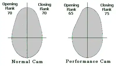

A performance camshaft...
is just a camshaft whose lobe profile is tailored to utilize more of an engine's potential.
Here is a visual comparison²:
bestservis.com

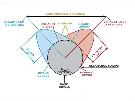

The performance improvement can come from two types of change:
  • altered valve lift
    usually a higher lift on the lobe, which increases in length of the valve stroke, which allows for more air to enter through the inlet valves, increasing the power potential of the engine.
  • altered valve timing - essentially modify when the valves open and close, which has an impact on the effective compression ratio, power output, emissions and other things.
Here is a neat diagram summarizing lots of camshaft-related terminology³:
Cam terminology
