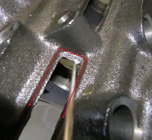

Stress risers are more pronounced at sharp edges. To help reduce the occurrences of stress risers, it is a good idea to reduce the sharp edges. A major occurrence of sharp edges inside of engines is due to casting flash. This is where the joint of the casting mold occurs which leave a sharp, pronounced edge. Here is a picture of what I’m talking about:

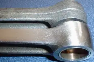

The inside the red lines is casting flash. If you’ve ever rebuilt an engine, you know how sharp these areas can be. This is the lifter valley of a V8 engine. Casting flash can occur (as I stated) any place where two parts of a casting mold come together. Another place to look for casting flash is on connecting rods. In the following picture, the top rod is stock in appearance and the bottom has had the casting flash removed.
You may look at the top rod and ask yourself, “This area does not look sharp. Why should I worry about that?”. The answer to your question is, the raised section, while not being sharp in feel, still provides a more pronounced area for a stress riser to occur. This area concentrates the stress. The bottom rod, after being cleaned up, actually will be structurally sounder because the stress has a lot less of a chance of concentrating and thus lessens the chance of stress risers. This process also makes the rod lighter, which means less mass being flung around. When doing this, you need to ensure the rods and pistons are balanced to ensure there aren’t any issues.

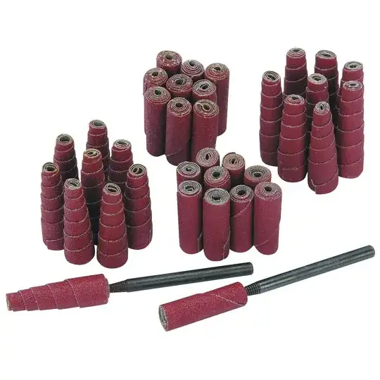

When rebuilding an engine, it is very good to go through the entire engine and remove all of the sharp edges you can. You can do this with a roll sanding tool.
These sanding rolls will quickly remove casting flash and smooth things up for you. You may need quite a few of them to through an entire block. Also, you can remove the sharp edges which have happened if you get your block decked, as the edges in these areas become sharp as well. Ensure you do not get over zealous and cause problems on your machined surfaces, though. Just be careful and take your time. You want it done right, which takes a bit of time to accomplish.
