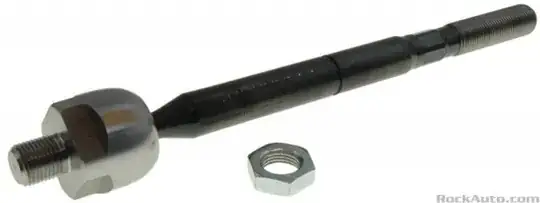

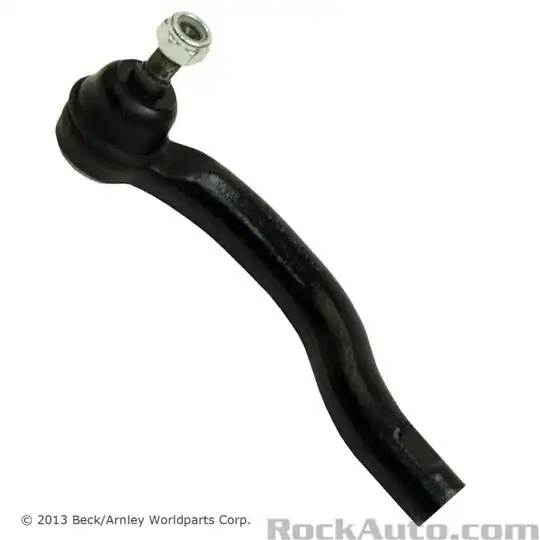

  1. Is the rod going from the wheel into the power steering drive straight? I.e. does it go directly from the wheel into the drive or is it hinged or curved or are there other parts in between?
Here's two images of what makes up the tie rods in your RAV4. The first is the outer (the bent one) and the second is the inner tie rod (the straight one):
The skinny end without the knuckle treads on the inner threads into the end without the joint on it of the outer. The knuckle on the inner threads into the end of your rack and pinion unit. The outer tie rod connects to the steering arm on your steering knuckle (near tire).
