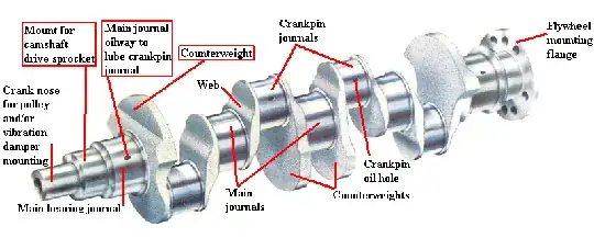

Let's first off describe the anatomy of a crankshaft. The different parts of the crankshaft are:
  • Main journals
  • Rod journals
  • Snout (or nose)
  • Flywheel mounting flange
  • Throws
  • Counterweights
  • Web
The main parts we are working with when grinding are the journals, both main and rod.

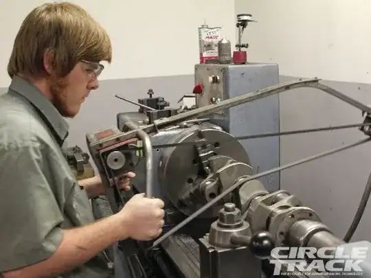

If the decision is made to reuse the crankshaft, but machining will be necessary in order for it to work, the machinist will grind part of the top layer of the journal away to make it smooth again. Usually (in the SAE world), the amount taken off is measured in 0.010" (usually 0.010", 0.020", or 0.030" - depending on the severity of the wear on the journal). Once the journal is ground down close to the final dimensions needed for the process, there is then a finishing process of polishing the journals. This involves using using a long circular piece of emery paper. The process looks like this:
The crankshaft is spun while in the opposite direction and the emery paper is put in contact with the journal. This process creates an ultra smooth surface on the crankshaft, which reduces friction, which improves overall power and torque.
