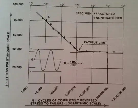

Simplistically put, under repeated (cyclic as opposed to continuous) stress the capacity of a metal to withstand stress gradually diminishes and, in most cases, cannot be restored. Metals which are subjected to fluctuating loads can and do break after a finite number of load cycles (or, more accurately, stress cycles) in which the loads applied and the resultant stresses imposed are always below the ultimate strength of the metal. This type of failure is termed fatigue failure.
(NOTE: I detail this further in an answer about stress risers)
Later in the book, Carroll Smith describes that parts which are made to handle stress can do so almost indefinitely if the stresses parted on them are below their engineered threshold. Once you go past the engineered threshold, the part won't normally fail right away, but stresses will add up over time. As the stress loads increase over the engineered values, the stress build up occurs at a greater rate until the part reaches failure. (ie: a part may be able to withstand 10,000 stress cycles at a given load, but double that stress and it may only be able to handle 10 stress cycles). Also, remember this is an accumulative effect: a part subjected to abuse will not heal itself.
Here is a scale which describes what Carroll Smith is talking about (copied from the book, pg 109, figure 93):
(NOTE: The above graph is used specifically for specific ferrous metal alloys, but the general ideas which are laid out through the graph can be used to describe how any metal will behave under stress.)
