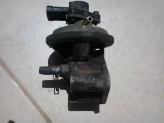

Has anyone run into an idle / stalling problem like this where forcibly enriching the AF mixture effectively masks the underlying problem? At this point the only two things that stand out are an extremely dirty intake manifold with a think coat of oily sludge on every surface, and when cleaning the EGR I noticed that one of the two vacuum ports on the EGR valve has been capped with a rubber cap and clamp.

I've confirmed that the EGR seems to be correctly set up for this model and I followed the autozone procedure for setting the idle suggested by Paulster2, and I'm back up to 8 K/L, but that's still 10% below my winter millage. And it still idles poorly right after start up, until I give it some gas and then it goes back to normal.
