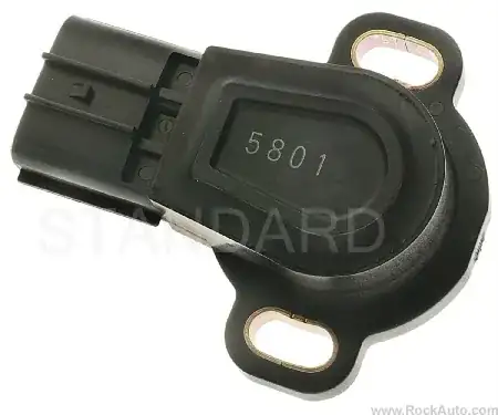

The TPS should look something like this:
