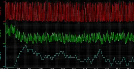

The first thing I pulled up was the O2 sensor and fuel trims at idle and just let it run a few minutes. The only load during this time is the radiator fan occasionally coming on.
O2_STFT_LTFT_Idle_No_Load
The thing which really stands out to me here is the lack of consistency in the LTFT. Even though it's in the normal range, it just seems to be wandering all over the place.

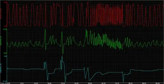

I then blipped the throttle twice and ran it at about 2k rpms for 20 seconds:
O2_STFT_LTFT_Idle_Blip_2.5krpms
Everything seems pretty normal here, AFAIK.

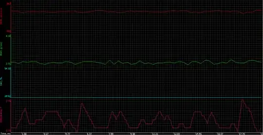

So then I checked the RPM, MAF, IAC Duty Cycle and Spark Advance PIDs with my scan tool while simultaneously checking the the IAC PWM frequency with my Hantek scope:
IACTest3_idleNoLoad
The WSM says idle should be between 650-750 with MAF reading 2.2 to 3.1 g/s. At idle, the RPMs are slowly oscillating by about 20-30rpm, and the MAF reading between 2.3 to 2.6. The thing that really jumped out at me was the spark advance. It's supposed to be between 6 to 18 degrees at idle, and it's slowly bouncing between 0.75 and 2.75. I verified this with a timing light and tried unplugging the knock sensor, which had no effect. There aren't any knock related codes.

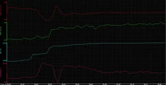

Next I started turning loads on at about the 41 second mark. Over about 2 1/2 seconds I turned on the brights, the rear defrost, the AC on high and finally put the car in drive with the parking break on.
iacTest3_AllLoads
As the loads are turned on, the timing advances to 20.5*, while the RPMs bottom out at 492 before recovering to 736. As the RPMs recover, the timing bottoms out to -2.5*, then recovers to 17.5* as the RPMs drop to 597. As the IAC duty cycle slowly increases to about 53% over ten seconds, the timing backs off until it's slowly rolling between about 6.25* and 8.5*.
The same scenario plays out when I turn the loads off; the RPMs recover to about 840 and the bottom simultaneously drops out of the timing hitting -3.5* before recovering to 2.5* as the IAC slowly backs off.
While I was collecting this data via the scan tool, I was also monitoring the IAC PWM signal with the Hantek. While the scan tool showed the IAC duty cycle PID at 28.5 during no load idle, the scope showed a frequency of about 1.5kHz and a duty cycle of about 33%. When the PID showed a steady 53.91% duty cycle under the loads, the scope showed it oscillating quickly between 574-604Hz and 65% to 67%. You can view a three minute recording of this data being gathered here.

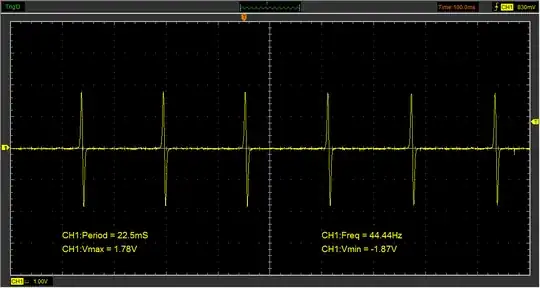

I also took a look at the camshaft signal on the scope. Idling at 750rpm the camshaft spins at about 6.25Hz. While the waveform I saw on the screen seemed OK, the frequency measured by the scope was all over the place, from 5hz up to a few hundred hertz. When I took this screen shot it was at 44Hz:
camTest1
Not sure if there is actually a problem there, if it's just an error in how I'm measuring, just noise or the scope itself. I'm of course also wondering if my scope IAC measurements are reliable.
