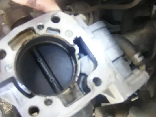

So I took off the throttle body and this is what it looked like:
The IAC passage didn't look particularly dirty, but I sprayed some carb cleaner into it from both the manifold side and the intake pipe without taking it off the throttle body. I also cleaned the throttle plate and sprayed some cleaner into the very nasty, dirty manifold for good measure. I also reset the ECU after doing this and it seems that the problem has been solved.

This sounds like a problem with the Idle Air Control (IAC) valve, or something in that general vicinity. You should try to clean it and the upper intake tract.
