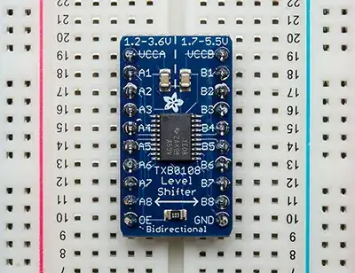

Since the question seems oriented towards an IC that provides bidirectional level shifting, consider the Texas Instruments TXB010x family of parts: TXB0102 has 2 channels, TXB0104 has 4 channels, and TXB0108 has 8 channels.
The stand-out feature of this family of ICs is that signal direction is automatically sensed, so a separate direction setting pin is not needed.
Switching speeds up to 10 MHz work reliably. The theoretical maximum speed may be higher - the datasheets are not explicit about this from what I can determine.
I have a TXB0108 working between a 3.6 Volt MSP430 Launchpad and a 5 Volt Arduino Nano, so the use case of the question is covered.
For the purposes of trying it out, Adafruit offers a prebuilt module incorporating the TXB0108, which saves you the trouble of soldering an SMD part. There may be similar options for the 0102 and 0104 from them or others.
8-channel Bi-directional Logic Level Converter - TXB0108

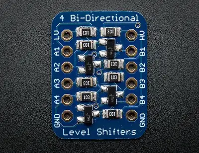

If the intent is to level-shift an I2C signal, which isn't ideally suited to the TXB series ICs, an option that specifically addresses the pull-up resistor and open collector topology of I2C is a module like this, again sold by Adafruit and other vendors.
I2C level shifter
This module uses BSS138 MOSFETs in the way described in the answer by alexan_e. While it is not a single IC such as the question asks for, it perhaps fulfills the intended purpose. Alternatively, it is simple to build this circuit yourself using MOSFETs.

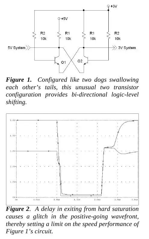

From the cheap[er?] solution department, the FET (from the accepted answer based on the NXP appnote) can be replaced with a BJT and Schottky diode as in Silicon Labs AN883. Their schematic is a bit complicated with other things, so I've extracted the essential bit here and reoriented it so it looks like in the accepted answer for easy comparison of the two schematics:
The BJT does translation in the low->high direction only... exactly as discussed in Single transistor level up shifter. The Schottky replaces the body diode of the FET for the high->low translation.
Below is their zoomed in scope measurement for a 3.3<->1.8V translator; they also propose this schematic for 5<->1.8V translation etc. When doing 3.3<->1.8V translation a MMBT3904 had only 150mV (saturation) drop. The BAS40 diode had 350mV drop in the opposite direction. These offesets affect (obviously) the logic-low level output on the low and respectively high side of the translator.
They had nice CMOS devices on both sides, so input impedance wasn't much of an issue. There was no visible degradation/offset of the logic-high margins in their 1V/div trace, so I haven't bothered including it here. The input impedance of their devices were at least 1Mohm from what I can tell from a simulation. Logic-high margins start to degrade below 100K input impedance or so.
Also, they recommend this BJT-based translator only up to 300KHz or so.
I'm not sure which of these solutions is cheaper in practice, FET or Schottky + BJT... but this one certainly needs more parts... unless you use one of those diode+transistor packages, which do exist, e.g. PZMT1101. But you also need 3 resistors.
