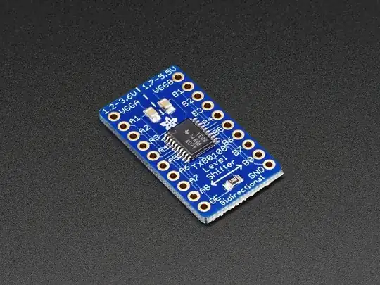

You might be able to use this. It's an 8 channel bidirectional level translator: -
One side works with logic level of 1.2 to 3.6 volts and the other side works at logic levels of 1.6 to 5.5 volts.
I would have thought that if your high side voltage logic is 6.6 volts, then supplying an input pin with a logic level of 5 volts (76%) would still be OK. When feeding out a 6.6 volt logic level you should protect the device with a 1kohm series resistor.
Or, you could use this device, the TXS0108E: -
Speeds in excess of 2Mbpsec according to the data sheet.
