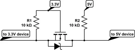

This is a very simple level shifter that will allow you to interface the two devices. The levels shifter is perfect for I2C because it is bidirectional.
schematic

    Can the person who down-voted this please explain why? It is not a terrible answer. Although this question could be closed, since it has been asked and answered multiple times. – user57037 Feb 22 '16 at 00:33
  • I'm not the downvoter, but maybe a passive-aggressive user thought this is a dupe and as such it shouldn't get an answer. Just disregard the vote and move on... +1 – Ricardo Feb 22 '16 at 11:52
If there are no 5V slaves on your I2C bus you might well get by with connecting the pull-up resistors to 3.3V. The voltage on those resistors determine the bus voltage, not the connected chips.
A consequence is that the 877 will see a lower voltage than it expects (with a 5V bus), so you might need to run the bus at a lower speed.
