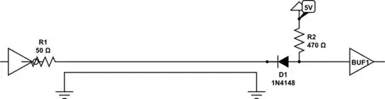

The diode level shifter referenced is a shockingly bad design and useless in many cases.
For Vin = 0/3V3, Vout ~= 0V6 / 3V9
If that meets your needs you are lucky - there are few needs that it would meet.
Someone pointed out that LS Schottky will meet the need - any gate - not just ones intended as level shifters.
Without going and looking at the various family's level specs, it seems likely that most TTL families would meet the need of 3V3 in/ 5V out.
So eg 74HCT244 datasheet here gives you 8 level converters per package as does 74HCT541 - both about $US0.45/1 Digikey.
A far better circuit than the dual diode one is the one shown in the question that you referenced - see below.
The main drawbacks of this circuit are
  • Iout = Iin - it does not provide any current gain.
  • Being "single ended" it has a slow low-to-high transition as the high level is provided by pullup resistor R2. For typical values of capacitive load this is probably not a major problem.
    E.g. with a 1 nF load time constant = RC = 6k8 x 1 nF ~= 7 uS, i.e. operation at perhaps 20 uS minimum per high level to be safe - faster would often work. Lower values of R2 will allow faster operation as long as the input driver is able to pull down the load resistor.
The 2N7000 circuit shown on the same page does not have the Iout = Ion limitation. It does have the slow rise time issue due to the single-ended output, but as the input does not have to supply this current a lower value of load resistor may be used with no impact on the input.
There are various level-shifter circuits around - almost all are better than the diode-based one. If you are still uncertain then please supply a requirement with voltage swings and loads documented.

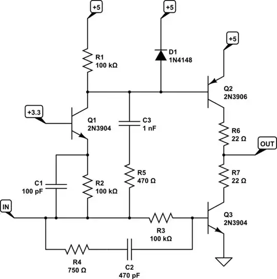

McMahon's circuit will work fine if you can find a BJT with very fast reverse transit times. (Low diffusion charge storage.) I like the idea of driving, by pulling through the emitter. But I worry a little that it will not work with the usual BJTs you might normally find. So if you want to try his circuit, make sure you pick a fast BJT. Perhaps try something like a 2N3391A, instead of a 2N2222A or 2N3904. Just be prepared to try different ones until you get a decent output at the frequency you want.
If the BJT has a poor reverse transit time, then you can find this out by observing the base voltage of McMahon's circuit with a 100X probe on the scope. Look for a voltage above \$3.3\:\textrm{V}\$. If you see the base higher, while driving the circuit fast, then you probably have to find a different BJT.
If you want to use pretty much any BJT, you'll need a different topology that is a lot more complex. I'm not recommending the following. (I think you'd be better off with McMahon's circuit and the right BJT.) But here's an illustration of what you might face if you want to use most any BJT:
schematic
Assuming \$200\:\Omega\$ driver impedances (and still more) it should keep up easily with \$1\:\textrm{MHz}\$. Drive currents will peak only for a very short moment, but generally will be at or below \$3\:\textrm{mA}\$. The circuit uses speed-ups (\$R_4\$, \$R_5\$, \$C_2\$, \$C_3\$, and \$C_1\$.)
Now if that doesn't convince you to use McMahon's approach, nothing will. But plan on selecting an appropriate BJT.

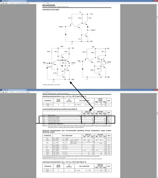

You can even use a 74LSxx input as the TTL gives excellent logic margin from 0.8 to 2V vs the 0.3 to 0.7Vdd or 1.5V to 3.5V limits desired for the input (which is even better than Russ and jonk's solution with the widest voltage margin and 10ns slew rates and can tolerate a pullup resistor in case of slight ringing, but not necessary. enter image description here
